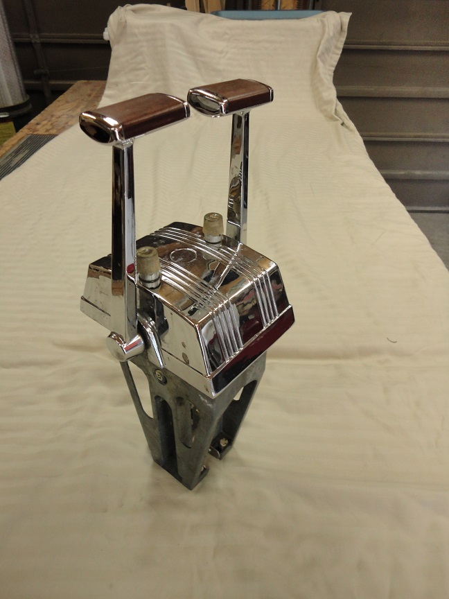

I will dig these out and post a picture, to see if these are the shifters that you need.
Re: Shifter/ Throttle Control
There does not appear to be a manufacturers name or model number (that I can find)
They seem to be complete and fully functional with no corrosion (these would never have been in salt water)
The plastic buttons on the top (to allow opening the throttle without engaging the shift) are in rough shape.
It will cost me the best part of $100 to package these up and ship to Texas from Canada.
They are yours for $100 if you want them.
