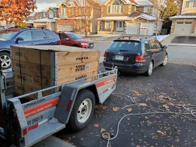

After paying a deposit the shop in the UK went about assembling a package for me and they test ran the engines in a test just the ensure all was well. In order to save money on shipping, they put the two engines on one pallet. It required removal of a few of the parts from one engine to allow the two engines to sit sufficiently close that the whole thing fit. Then they sent it via FEDEX air-freight. FEDEX engines? Are you crazy? It turns out that it wasn’t all that bad. FEDEX has a freight business that is relatively competitive. We spent some time researching shipping by boat, but it would have meant picking up the engines in Montreal or some other sea port. As it was, they were able to ship the engines to the Ottawa airport.
When the engines arrived, I rented a trailer (after making sure FEDEX could load the engines for me) and drove out to the airport. First stop was the FEDEX office to pick up the customs paperwork. Then over to the Border Services office to pay the taxes. The Border Service people took a little bit of time to figure out the right codes for marine diesel engines (used), but eventually determined that there were no duties, registration fees, inspections, safety certificates or other paperwork things. I paid the taxes and got the form that allowed FEDEX to release the engines to me, so I went back to the FEDEX office and handed them the paperwork.
The FEDEX folks were happy enough to load the engines for me, but I needed to wait for a bit while they found a forklift operator. I backed the trailer up to a big loading bay door and eventually a forklift appeared with a crate on the forks. The forklift operator was very skillful and was able to load the crate just forward of the trailer axle so the trailer would be stable. I knitted the crate to the trailer with some rope to keep it from sliding around and headed home.
When I got home with the trailer, I realized that I had a bit of a problem. I needed to unload the engines from the trailer. I undid all the rope and hopped in the trailer to slide the crate out. This is when the brilliant move of putting two engines in the crate came to haunt me. It should be noted that these are, in fact, very light weight for diesel engines. Just because they are light for diesel engines doesn’t make them light in absolute terms. Each engine weighs around 600lb, and by simple math, a pair of them weighs 1,200lb. I’m moderately strong, but that crate was simply not going to move with raw muscle power alone. I found a suitable length piece of lumber and used it as a lever to lift the back edge of the pallet and inch it forward in a bit of a ratcheting action. I got the whole thing to the back of the trailer to the point where it was teetering onto the tailgate. I slid the pallet down the tail gate and it came to a halt when the first edge hit the ground. Once again my muscle power failed me, so I took the easy way out and used the power of the car to pull the trailer out from underneath the crate. Success! The crate with the engines was now inside my garage.
