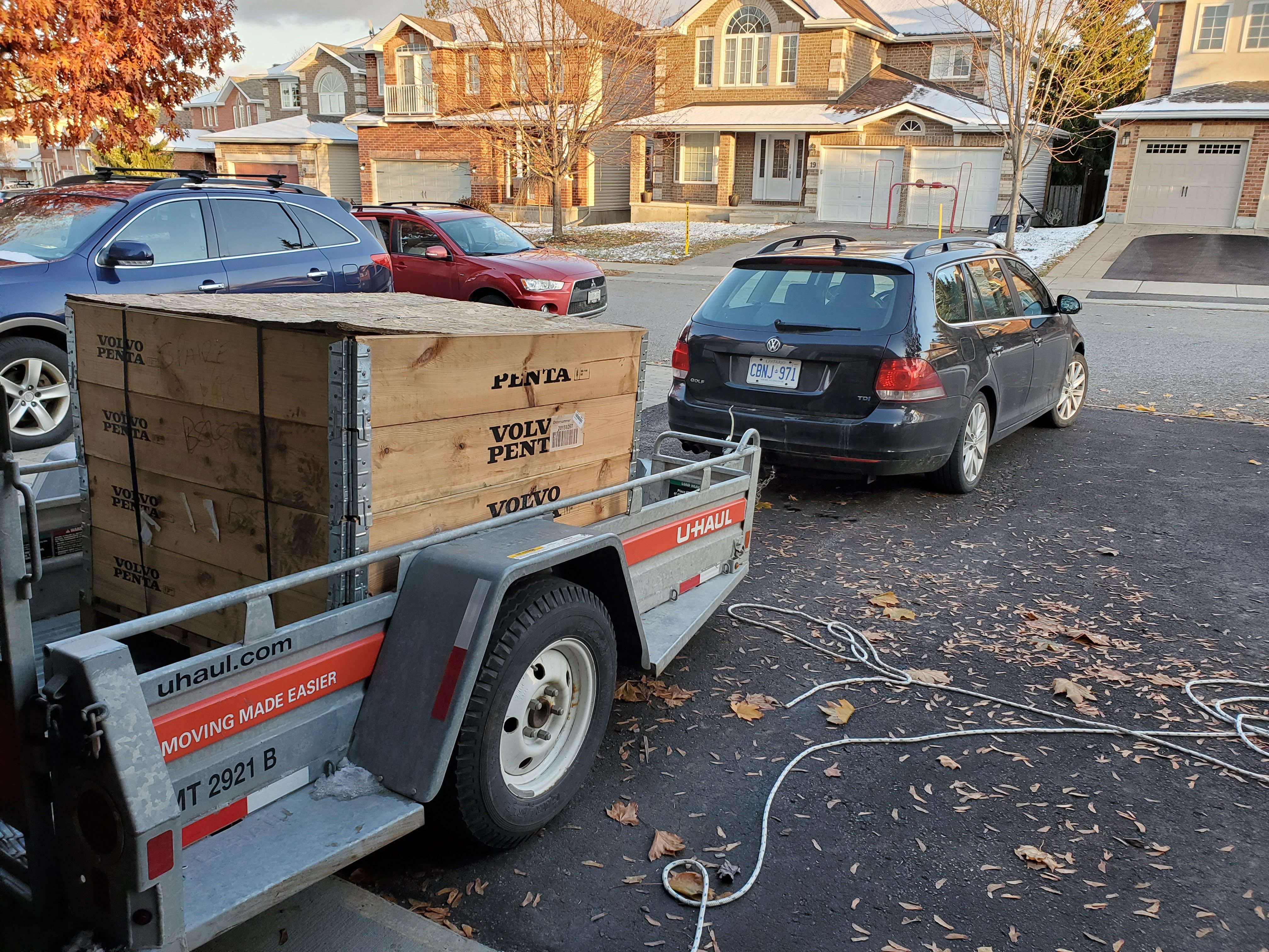

When the engines arrived, I rented a trailer (after making sure FEDEX could load the engines for me) and drove out to the airport. First stop was the FEDEX office to pick up the customs paperwork. Then over to the Border Services office to pay the taxes. The Border Service people took a little bit of time to figure out the right codes for marine diesel engines (used), but eventually determined that there were no duties, registration fees, inspections, safety certificates or other paperwork things. I paid the taxes and got the form that allowed FEDEX to release the engines to me, so I went back to the FEDEX office and handed them the paperwork.
The FEDEX folks were happy enough to load the engines for me, but I needed to wait for a bit while they found a forklift operator. I backed the trailer up to a big loading bay door and eventually a forklift appeared with a crate on the forks. The forklift operator was very skillful and was able to load the crate just forward of the trailer axle so the trailer would be stable. I knitted the crate to the trailer with some rope to keep it from sliding around and headed home.
When I got home with the trailer, I realized that I had a bit of a problem. I needed to unload the engines from the trailer. I undid all the rope and hopped in the trailer to slide the crate out. This is when the brilliant move of putting two engines in the crate came to haunt me. It should be noted that these are, in fact, very light weight for diesel engines. Just because they are light for diesel engines doesn’t make them light in absolute terms. Each engine weighs around 600lb, and by simple math, a pair of them weighs 1,200lb. I’m moderately strong, but that crate was simply not going to move with raw muscle power alone. I found a suitable length piece of lumber and used it as a lever to lift the back edge of the pallet and inch it forward in a bit of a ratcheting action. I got the whole thing to the back of the trailer to the point where it was teetering onto the tailgate. I slid the pallet down the tail gate and it came to a halt when the first edge hit the ground. Once again my muscle power failed me, so I took the easy way out and used the power of the car to pull the trailer out from underneath the crate. Success! The crate with the engines was now inside my garage.

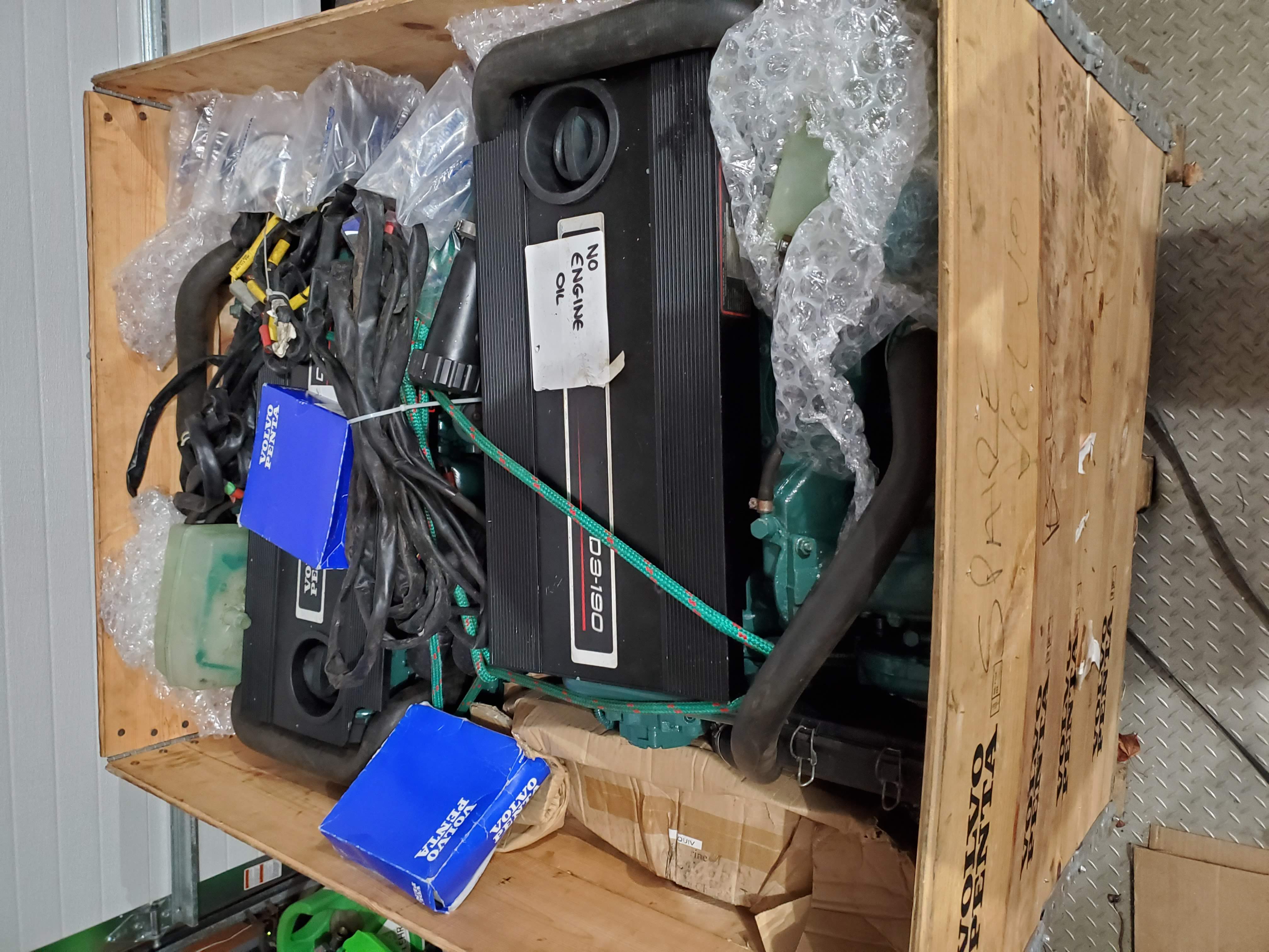

One of the things that had me a little concerned about the new (used) engines was the engine management system. The engines that I bought are 2008 vintage. They have the Volvo Penta Electronic Vessel Control (EVC) system, but it is the dash-C variant (EVC-C), which makes it obsolete. You can still get parts, but it is really difficult to find information on how to hook it all up. Would I need a new binnacle? Would I need to add electronic shifters?
When I uncrated the engines and started exploring the situation, I found that I had gotten pretty lucky with the specific engines I had purchased. Each engine had a black box on a short umbilical wire that looked like the sort of box that would contain electronics. Mounted on the black box was a small arm on a pivot. The arm had a hole in the end that looked just about right for a throttle cable. A little web sleuthing confirmed that this was indeed the throttle control and it meant that I wouldn't have to replace the binnacle and I didn't need to convert to electronic shifters. I was almost disappointed as I had a few minutes at the helm of Limitless which had the full electronic control package and saw just how slick it was. Oh well, on to the next issue.

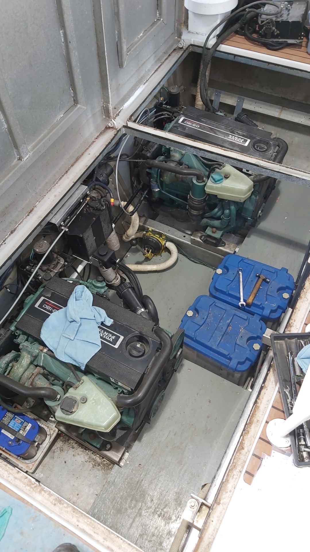

Celebration! I saw video of the engines running. They were only started for a few seconds, but it shows that they are hooked up at least somewhat correctly and the electronics are working. The boat now waits until Spring launch to see how well it all works together. This repower is being done on the cheap, with a lot of stuff coming from eBay. It all looks pretty good on the surface, but you never know what lurks under the covers. I am now imagining all kinds of possible issues between the engines and the stern drives. Bad bearings, broken gears, leaky valves, plugged passages. They wouldn't stop the engine from firing, but they could sideline the boat for a long time.
Speaking of doing it on the cheap, I saw the invoice for the installation. I was very curious to see the list of parts that were needed as I had worked pretty hard to assemble everything I though would be needed. I think I did a pretty good job as there were no big surprises. However, there were a LOT of parts still needed that I hadn't considered. Things like filler hose for the fuel tanks. The tanks were being removed to weld on fuel return fittings for the diesel engines. The 50 year old filler hoses were simply cut off to remove the tank. Putting back the tanks required replacing the filler hoses and that stuff is not cheap. So, while no one thing was super expensive, there were a lot of little things.
Regardless, the engines are in and the boat is back in the yard waiting for the lake to thaw. I am super excited to get down to the boat and see the green engines in their proper homes. I am anticipating the next set of problems dealing with the electronics, propellors and other things that were best guess at the time. More to follow in the Spring.
