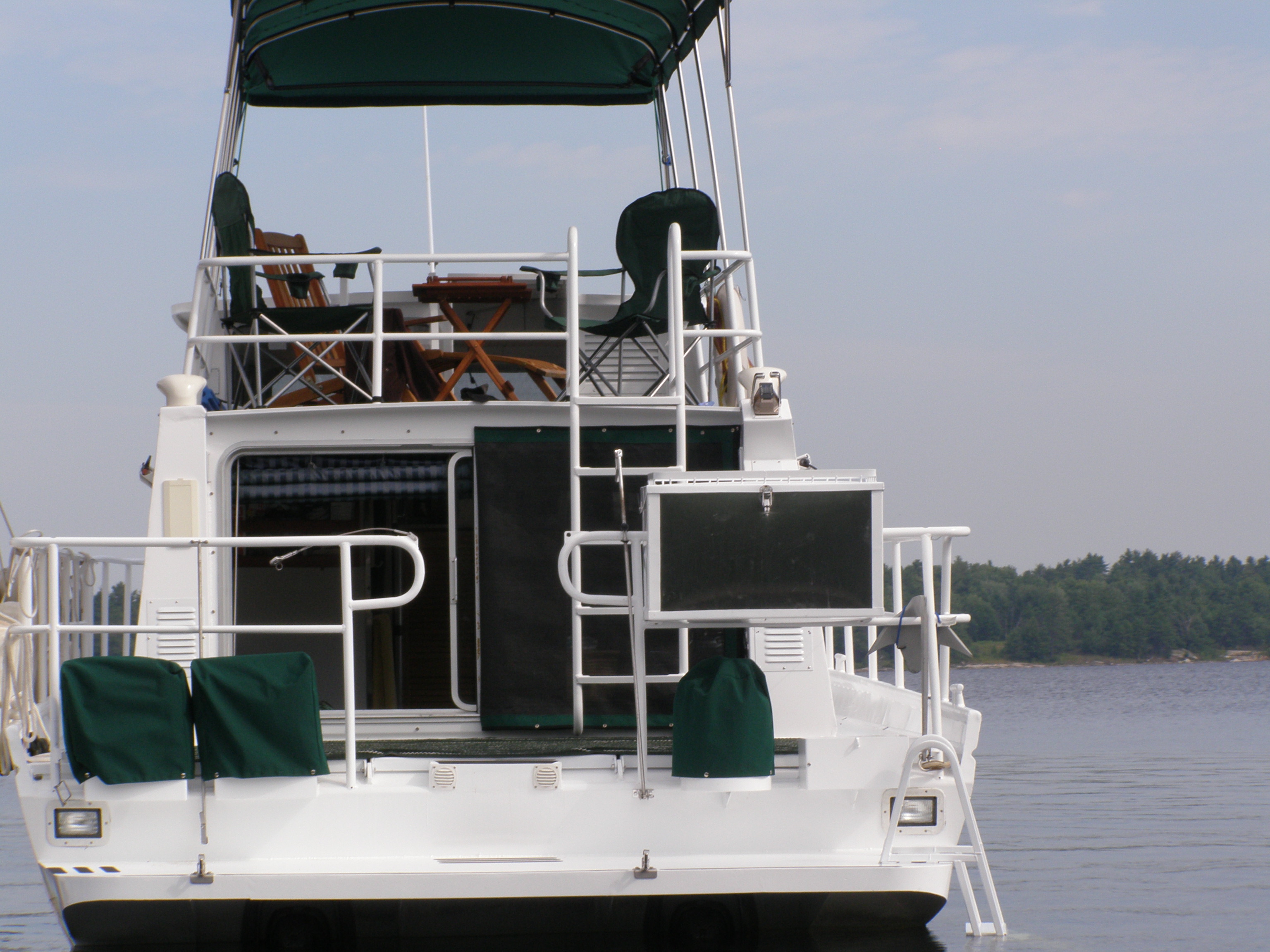

Here is another idea re: screening. We were not aware prior to this website that the window manufacture was still afloat. What we did was custom made snap over screens that also provide 40% sun shade to limit solar gain. The pilot house windows, entrance door/window, including the large stern window cost aprox. $200. Attached you will see the pics, you might have to enlarge the pics to see the screen coverings.
