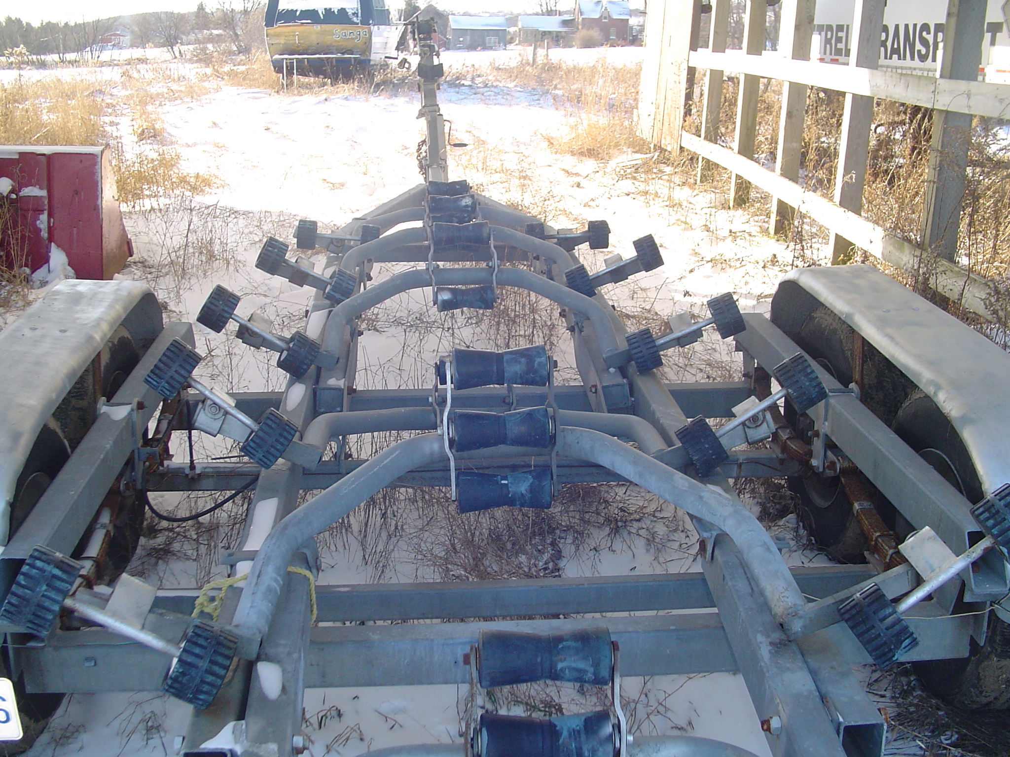

I have my 69 Alcan 37 on a new triple axle aluminum trailer (see pictue at teh bottom of the "I think I'm in love" thread on this forum). I bought it new for $7,000 USD delivered. Made for salt water - all aluminimum/ stainless construction - Its rated at 18,000 lbs and 40'. Electric/Hydraulic brakes on all wheels.
I set the boat up based upon an approximated balance point. I have yet to move the boat with the trailer (I set it in place with a crane) . I have been trying to devise a way to figure out he tongue weight so that I can finalize the position and finish setting up the trailer. Best thought I had thus far was to get a hydrualic cylinder with a presuure gauge and calculate the weight. I have not done ant shopping for a cylinder yet. Does anyone have an other idea on measuring the weight?
I have to go ~5 mile by highway to get to my launch point and I plan to hire someone with a truck to move it. I am not sure if I am going to worry about measuring the tongue weight for now. I plan to launch this @ April.
