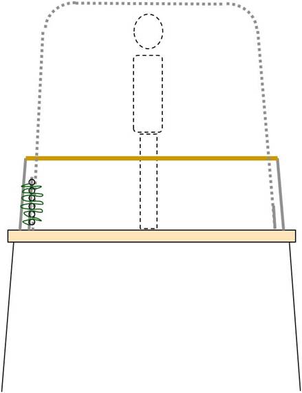

Design Criteria for the Top Deck Sunshade on Catherine Ann
  • Had to be stowable ( my personal opinion is that the lines of the boat look better without a permanent sunshade or frame).
  • The frame could not block the aft or side ladders when folded. (Catherine Ann has a side ladder not found on most of these boats)

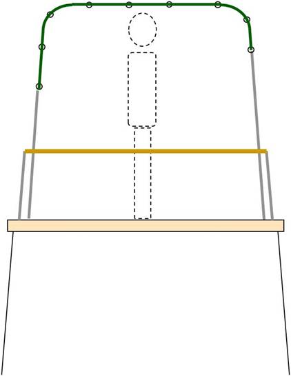

  • The sunshade should be adjustable to block the sun on either side of the boat while minimizing the obstruction of the view from the topdeck.
  • Construction should be substantial enough to withstand moderate wind gusts but be easily taken down for heavy weather or when underway.
Sunshade should move from side to side on the frame as the position of the sun changes.

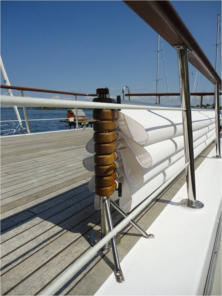

Sunshade should collapses on to posts on the port side for storage.

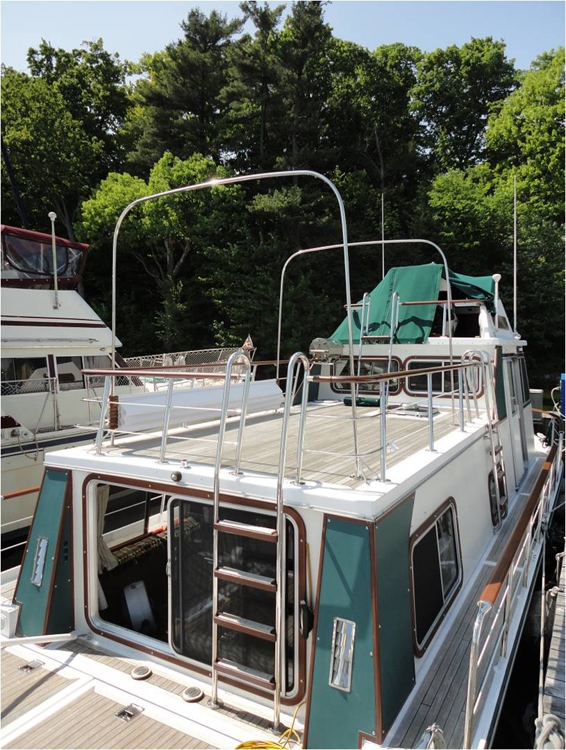

As Built

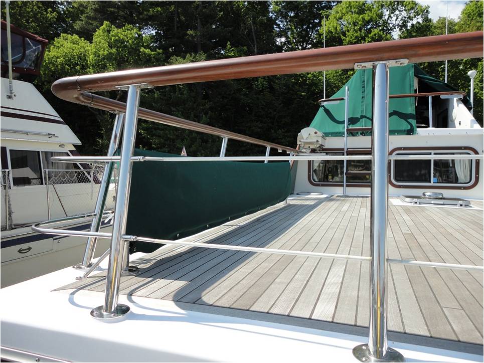

The sunshade is shown collapsed onto two short posts on the port side of the deck. The end hoop frames come apart and can be stowed in the flybridge.

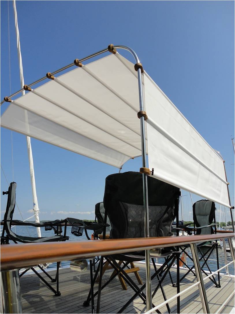

The horizontal ribs of the sunshade are light weight aluminum tubes.
Teak end pieces allow the sunshade to slide back and forth on the frame.
The frame bases are permanently attached to the deck and store the sunshade along the port side.

The sunshade material blocks most of the sun but is an open enough weave to let the breeze through and allow some visibility.
Storage When Underway
The sunshade collapses on to the two posts on the port side of the deck and has its own cover.
