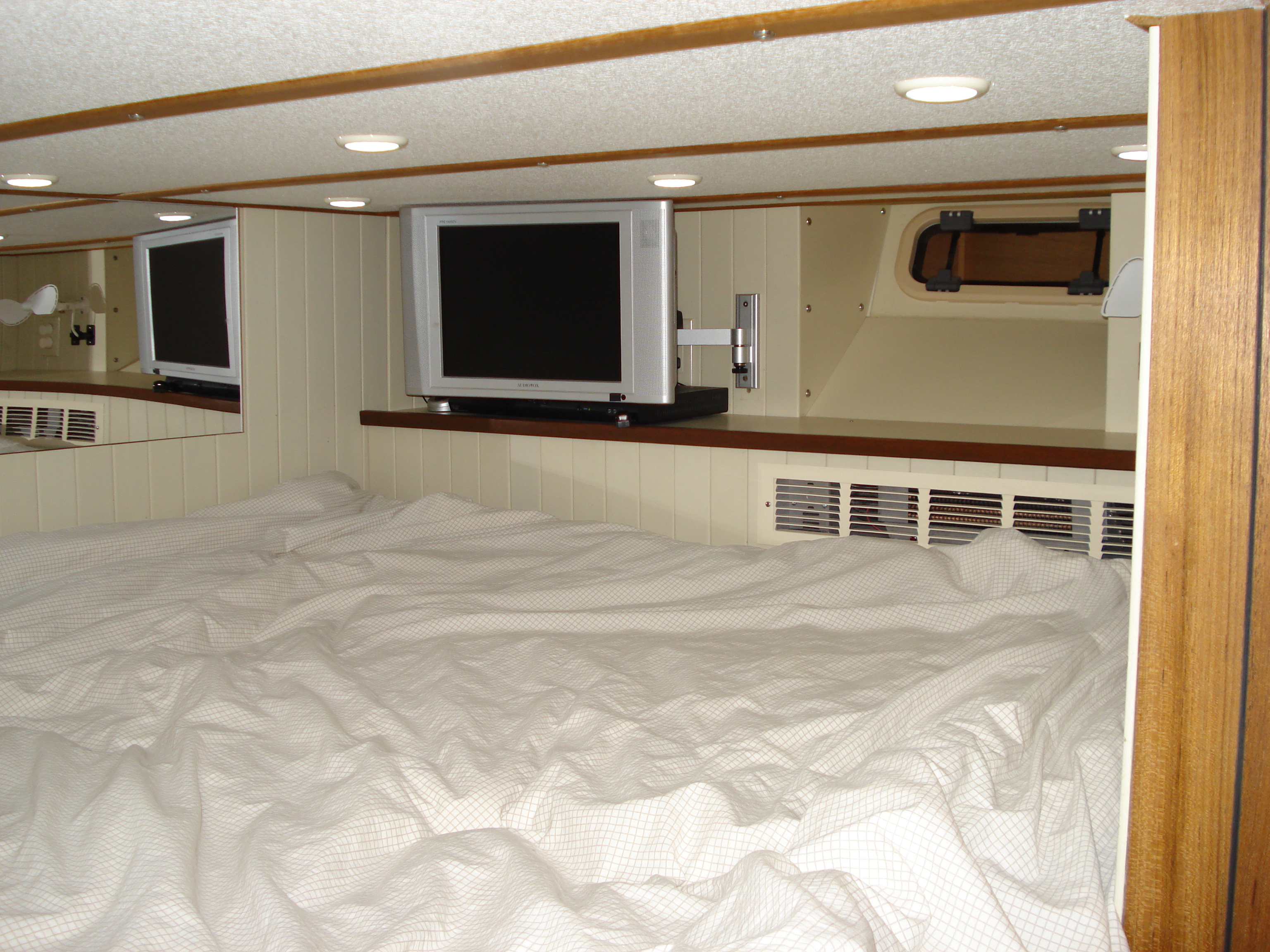

The most recently completed project is a total redesign and reconstruction of the lower forward berth.
I actually managed to get a 60” x 80” x 7” queen mattress in there !

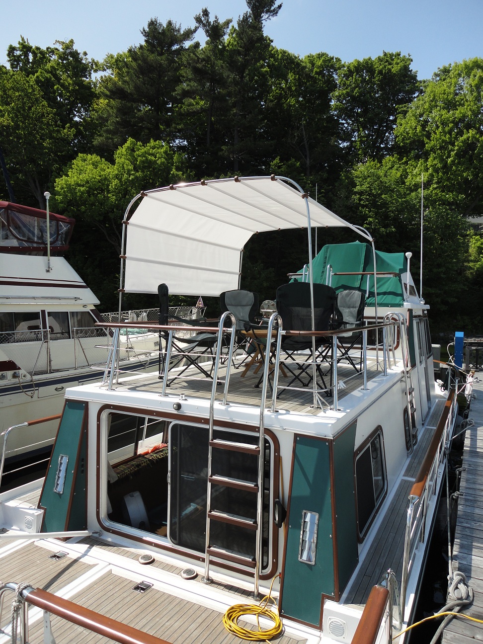

I have also come up with a design for a completely stowable full topdeck sunshade. I will post pictures of this . . . if it works !

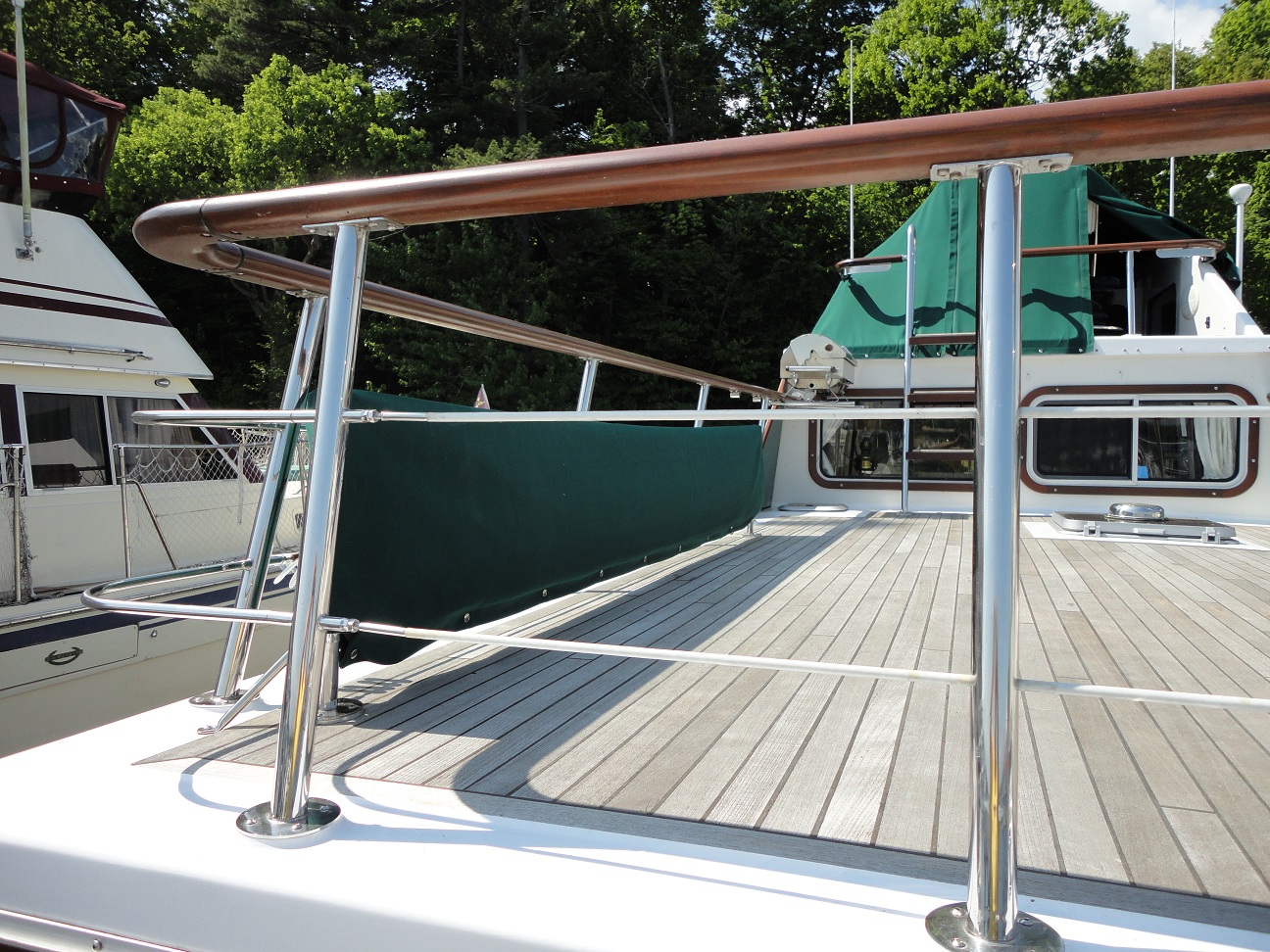

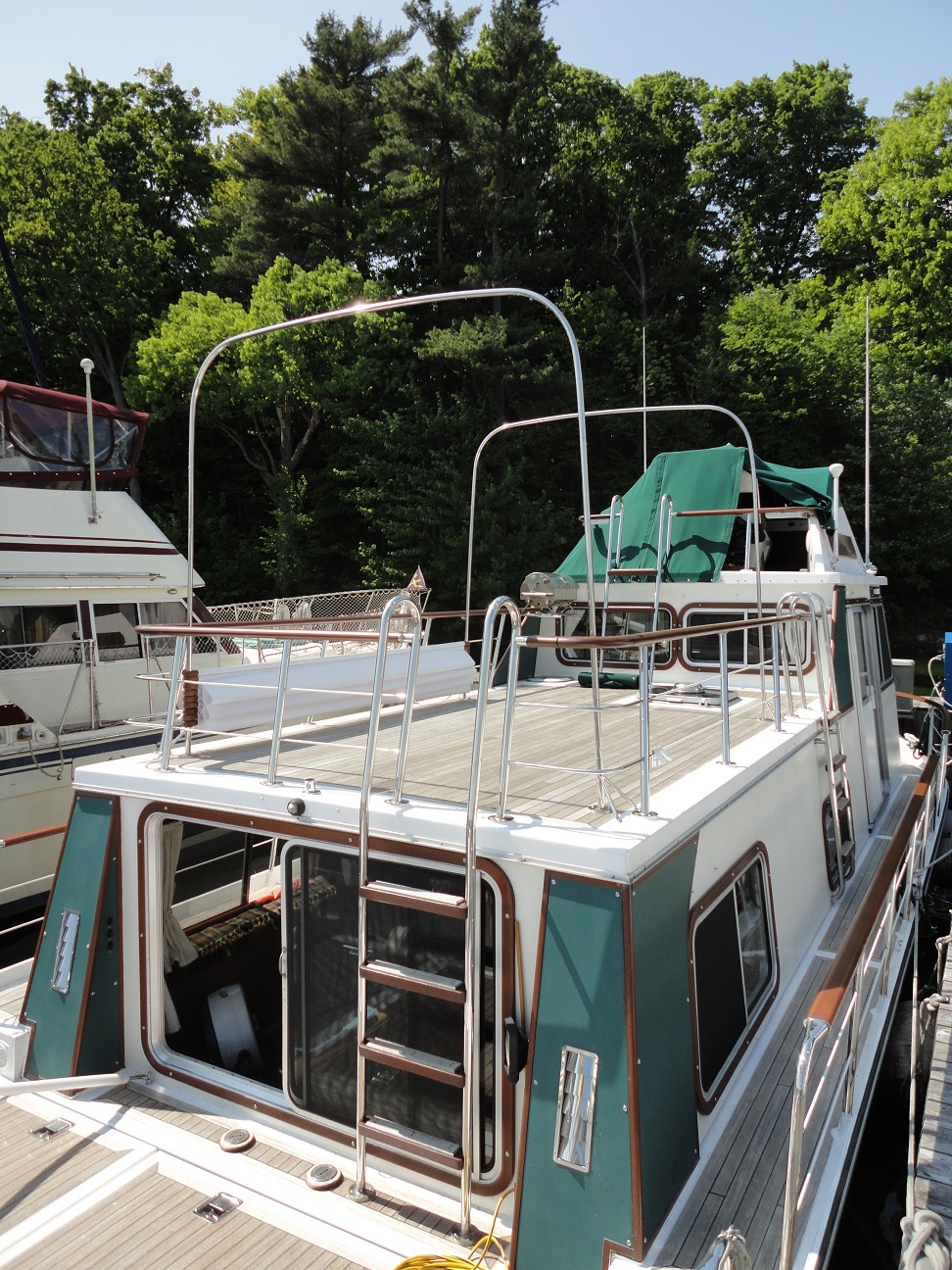

The stowable topdeck sunshade works !
It is made from a breathable fabric that lets the breeze through, but blocks the sun.
It can be repositioned from one side to the other as the position of the sun changes. It collapses on to two short posts on the port side of the deck and the entire frame comes apart for stowing in the flybridge The collapsed sunshade then has its own storage cover.
